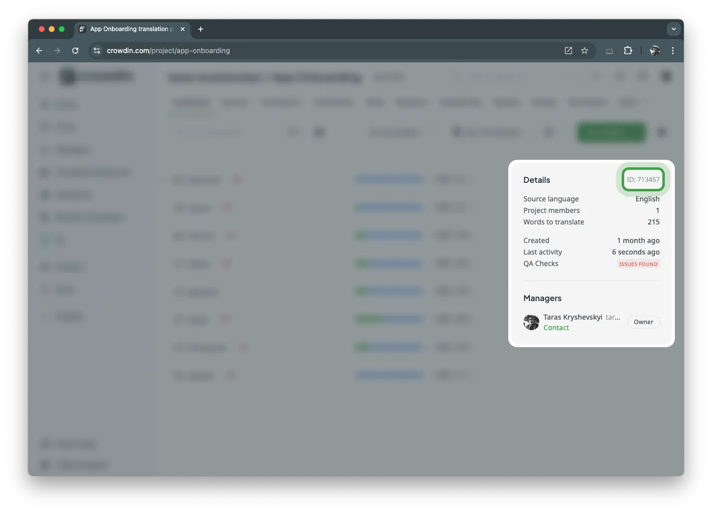

Create Translation Project
The Crowdin project is just like a Git repo but for translation files. To create one, visit this page. Once you have completed this step, you should find a Crowdin project ID and save it.

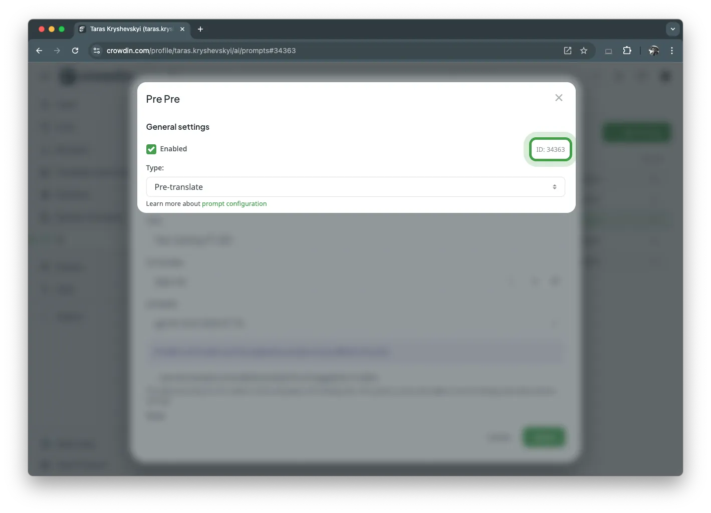

Configure AI Provider and the Prompt
Please follow the quick start guide to configure AI in your Crowdin account. Once completed, you will be able to find a Prompt ID, which is needed for the next step in this guide.
